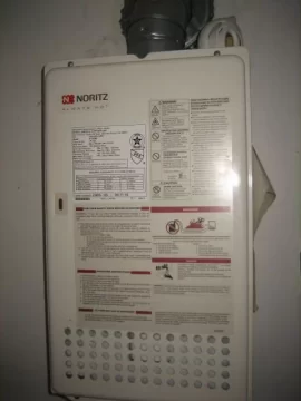

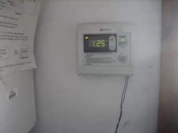

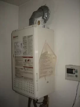

I have a Noritz tankless lpg, love it. It fills my wifes whirlpool tub just fine. According to the doe website, if you use 60 gallons of hot water per day at $1.25 per gallon, you will save $34.00 per month. Dont forget about the $300.00 tax rebate when figuring your savings.
Your tax rebate check could cover the costs. Check out irawood.com for many brands, electric, gas, and lpg.
