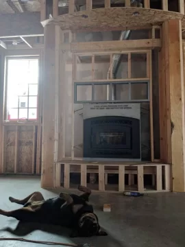

@begreen here is a picture of the progress ...don't mind the silly Rotty
[Hearth.com] Swapping a double for single window?
Reactions: diverscale
Looking good, that's going to be nice. FWIW I'd be thinking wood storage under that hearth.
PS: Love the Rotty.
Reactions: En Fuego and Ashful
The dog is just practicing different roasting positions
