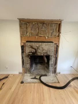

I just recently demoed the brick that was covering the face of the chimney and decided I’m going to build a setup with a raised granite mantle and granite face. In doing this I opened up quite a larger opening for the chimney and I can now fit the 3500.

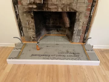

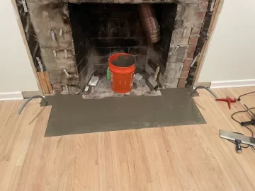

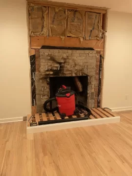

So here’s some pictures of the build so far and I’m wondering if my hearth platform needs more to not set the 2x4 frame under it on fire.
I felt like this was going to be enough but I’m not seeing enough information on this to say it’s right.
Ontop of the cement board there is going to be a granite slab. Then ontop of the granite slab will be the new wood stove.
Thoughts?

Truth be told, that is not a good location to use wood studs. The insert needs a totally non-combustible hearth. It gets much hotter than a freestanding stove both underneath and in front of the insert. The hearth should be redone with cement, brick, or metal studs underneath.

Dam, I’ll fill this whole moulding frame with cement if my floor can hold all the weight +550lb insert ahha
