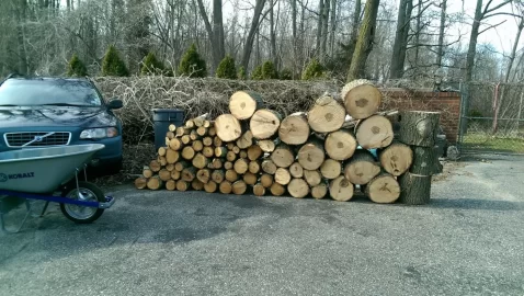

There are 13 more of the big rounds off to right that you can't see. Approximately 22 to 24 inches in diameter.
As long as you have splitter, wood is wood. Hand splitting gum is something else. That's when I would say keep it.

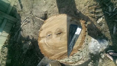

Ok, partial update. I toot a medium sized round home with me yesterday. Put it on the block and used a grenade type wedge. You can see in the picture the two spots where I placed it. It went in a few inches and stalled. Then it literally bounced out.
[Hearth.com] Sweet Gum Question

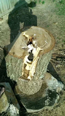

I took a few whacks for fun with my splitting axe and it just stuck in it. Made a nice THUNK sound. Very wet too I might add. I was able to noodle a piece off. I then decided to go back to the wedge.
I got it busted but what a chore. The wedge just sunk in and got stuck.

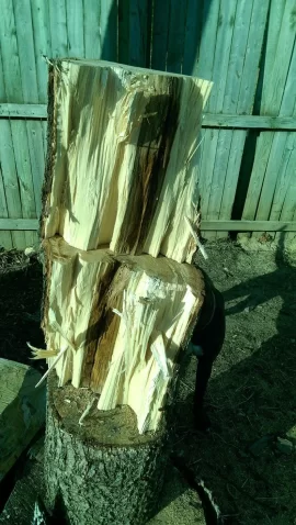

I then was able to rip the round apart by hand and get the wedge out. Sweet Gum has a very weird consistency. Weird grain too. Hard to describe but it doesn't lend itself to hand splitting at all. Next pic is the 2 parts of the round. They are stacked on top of each other.
Very weird wood to say the least. I see why anyone who splits by hand would turn it down even for free.

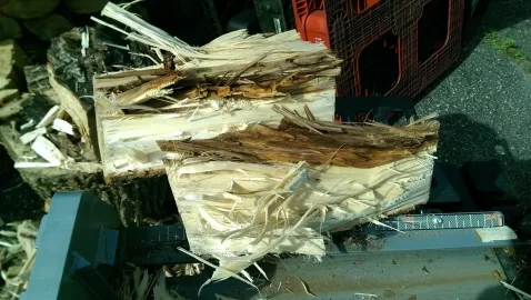

This stuff is awful. Even with hydraulic goodness. It just tears. Very stringy too. I hate it.
What a mess. It doesn't split even remotely straight.
Unless you have no other options I'd avoid this stuff like the plague. Once I get a few years ahead I will not be using this stuff again, even if given to me.
