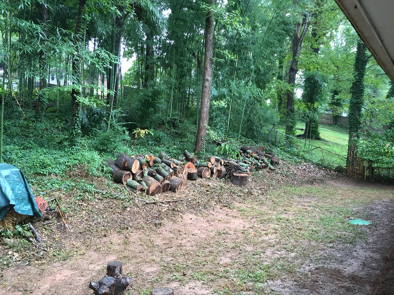

Yes, I'm aware of the pitfalls and PIA splitting techniques... Had 2 trees taken down in my yard. One was dead standing...wondering about when to split and if I can leave the rounds on the ground for a month or two?? A friend is going to help me split and will take half, but he can't help till mid November.
Should I cover them or get them off the ground ASAP?? Tia
Won't make much difference. The stuff is wet as a sponge just off the stump. If you are hand splitting, I feel for ya.

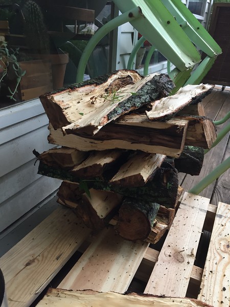

I split a few small pieces with my little 4.5# maul, surprised it wasn't terrible.
[Hearth.com] Sweet gum ?
But I've got a few more to go...
Is this stuff worth using as kindling??? Wondering if I should split a bunch small for that purpose.

We used to cut & burn sweet gum every year. I'll share our experiences with it.
By all means, you'll need a hydro splitter to work up gum. I'll never forget the time years ago I buried two wedges in a gum round and it wasn't a bit fazed. Dad saw that and laughed. We had to burn the round to get our wedges back.
Gum tends to split better and smoother after it's set in the round for a few months. This could be your scenario with a standing dead tree. Gum really doesn't split well green off the stump. Tears and shreds is more like it.
You can leave the rounds set on the ground for a few months; they're mostly water weight anyhow. You'll probably see some mushrooms start growing on it. By the way, sweet gum is a preferred wood for growing mushrooms.
Burns OK after a year stacked, Burns even better after a couple years stacked and top covered. Heat output is mediocre when you consider the bull work involved in splitting it. And it leaves a lot of ash behind.
Probably will work well for kindling but there are easier ways to get kindling than wrassling with gum. :)
Lots of water weight in those rounds, but I agree with other posters, split it, stack it, burn it after a year.

I wouldn't try to make Sweet Gum kindling. For kindling you want something that is really easy to split and splits straight. I usually make pine kindling, and only the most straight-grained pieces of pine become kindling. Make it easy on yourself and split the gum only as much as necessary.
