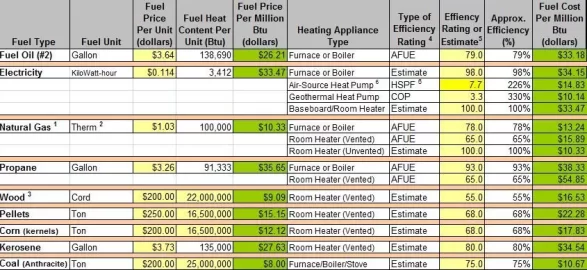

    Searching on hearth.com , I found this calculator: http://www.eia.doe.gov/neic/experts/heatcalc.xls
    It doesn't seem like it would pay to switch to propane.
    Maybe a high efficiency oil boiler.

    This is the spreadsheet I was talking about.
    For my area, 3.64 for oil and 3.26 for propane, per NYSERDA website.

    That shows natural gas being cheaper than wood. We're all idiots for burning wood. lol

    Notice that they used 55% for wood heat efficiency... can anyone say smoke dragon.
    I have NG and Ive done the math. 75% stove vs. 83% boiler and at today's prices - break even is around $200-225 an honest hardwood cord. If you are scrounging or getting your wood cheap its still worth it.
