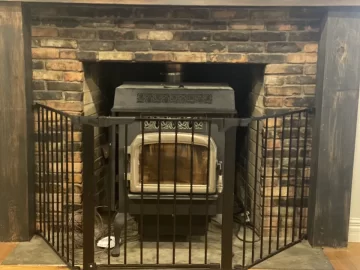

Hello everyone, I’m currently looking to replace my pellet stove with a wood stove. Looking for some opinions on if you think I can fit a free standing stove inside my fireplace or if I should limit my search to just inserts. Fireplace is on an interior wall, main floor of a two story colonial. Fireplace measures 38” tall x 40” wide and 25” deep with a 16” pad in front. I checked out a regency 3500 but at a height of 36” I’m guessing it’s a bit too tall. I’m looking to use this full time to heat my home, currently the pellet stove I have installed heats my entire house, 1800sq ft. Here’s a current pic of my setup, pellet stove hooked up to a 6” liner. Any thoughts/opinions on what the best setup may be would be great! Thanks .

That's a good sized fireplace. Take a look at the Pacific Energy Summit. It's 31" tall. It looks like the underside of the mantel should be shielded in this location.

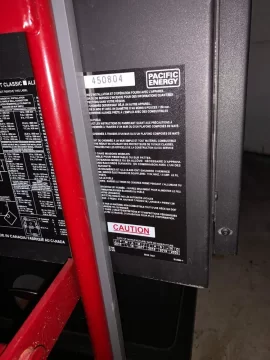

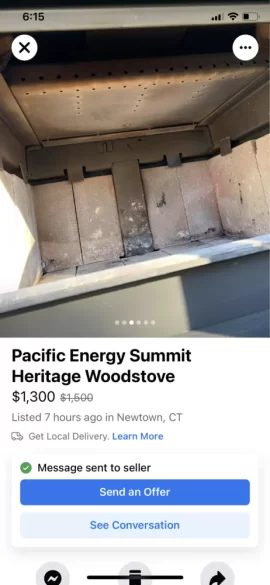

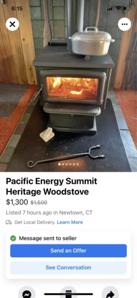

So I’ve been taking my time since I have the pellet stove and oil prices have been low. I came across this summit listed near me. He says he bought it new in May of this year and burned three fires in it, tag on the back says it was manufactured October 2016. Any thoughts on the stove, looks clean?

That thing looks almost brand new, I'd believe the three fire story (for once), unless the seller got in there and scrubbed the firebrick and steel.. And that's a bit more than half price for that stove.
(Does anyone know what that pot stand thing is in the picture?)
