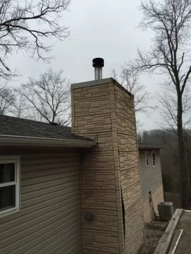

As I plan for next winters stove and pipe change, I'm considering going from a thru the wall pipe to a thru the ceiling. The chase is a pile of crap ( LONG story)and I'm taking it all down to either expose the pipe and strap it to the building, or removing it all, and going thru the roof. While I know that using the existing set up would be easier and cheaper, I'm going to have to use some sort of extension on the outside where the wall thimble and the T meet and transition vertical. The chase is half built into the wall of the house and there would need to be an extension between the T and thimble to come out 2' to clear the soffit, fascia and gutter. I think that is going to look really silly but that is just a guess. Here is a pic of what I will be removing. I keep going back and forth on the best approach here while being frugal. I don' have any issues with draft so if it stays the same set up pipe wise, I'm fine with that, but this mess of a chase/squirrel highway is got to go!

I vote for keeping/rebuilding the chase. The chimney terminus is nice and high for good draft. I don't think a shiny pipe with bracing that high will look as good. Plus, you can put more flues in there...I have three.

I've considered that for a few years. Without boring you with all the reasons why, that thing is a mess from top to bottom. It would be more expensive and be a much bigger headache to keep it. If I could cover that in stack stone veneer or something and redo it from the ground up, maybe, but thats much to expensive. Yes, it would look better but not so much better that I'm convinced to keep it.
