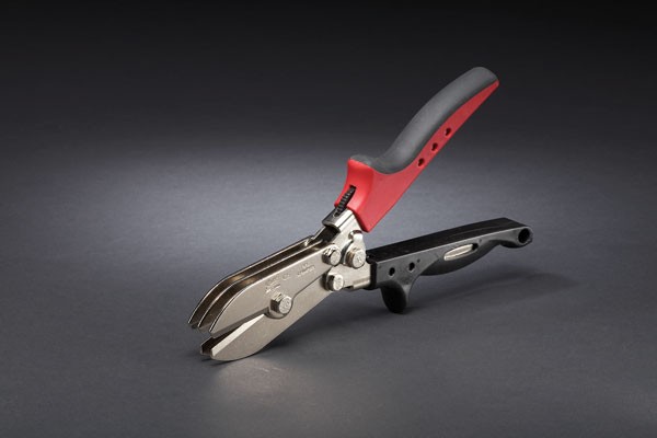

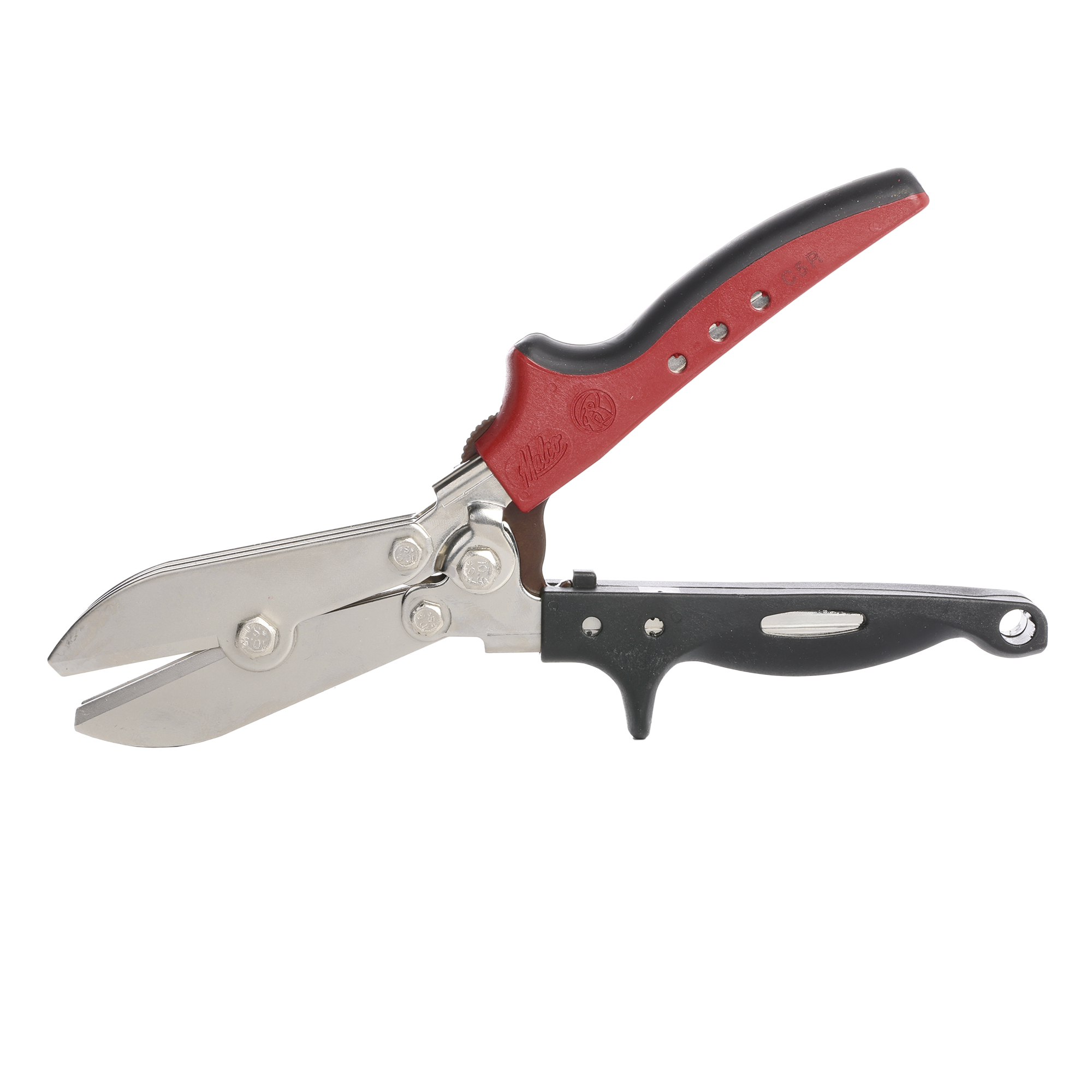

1. Can you crimp the snout on the T connector? If so, HOW...it's pretty sturdy stainless?
