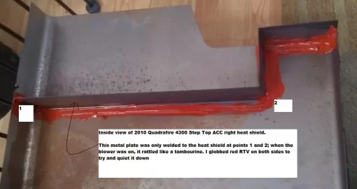

Yup, using the mild temps for maintenance....cleaned the stove, replaced the door gasket, swept the chimney and finally found out why the right heat shield on my Quadrafire 4300 would not stop rattling. After a test burn yesterday with the blower on high, it no longer rattles.
