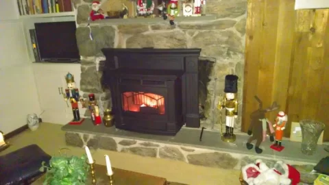

Update: the igniter is bad so I will need to wait a few days to replace it. I did fire the stove up a few hours ago with a torch. It seems to be running well. Waiting to see what the temperature in the house will be come morning. I'm also waiting for the cosmetic/finishing touches on the install.
Heres a quick photo. You can see I'm waiting for the oversized trim package to arrive.
