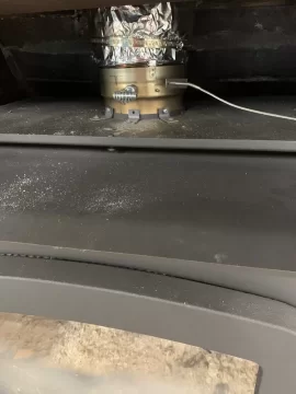

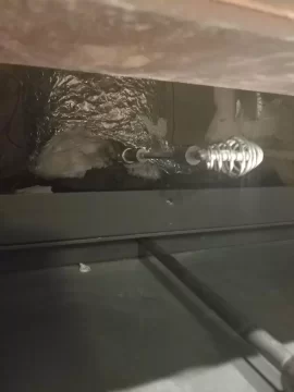

So you had damper installed on your insert? If you have a picture of what this looks like I’d love to see it. I can’t find any pics of an insert with a damper online and one of the dealers in my area said he’s never seen or heard of one being put on an insert. We live in NC where the winters are mild and I’m guessing the wood stove installers and sweeps up north have a lot more experience than our guys down here lol.I ran a Lopi Freedom on a 28' 6" insulated chimney I ran it for a few months with no damper. It was hard to keep it from overfire and on windy days it seemed like it would suck the flames up to the top of the stove, the burn times maybe 6 hours. After installing the damper temps were much more manageable, the wind issue was better and burn times were 7 sometimes I could get 8 hours. I have since changed to a PE insert and a hi wind cap. The PE will overfire if quicker than the Lopi if I am not careful but I do seem to get constant 8 hour burn times.
I do 5 to 10 a year. You need to fabricate some sort of linkage from the damper in the pipe to a handle coming out through the surround. I usually use fireplace damper handles that fit on 1/4" rod. And u joints for 1/4" drive sockets.So you had damper installed on your insert? If you have a picture of what this looks like I’d love to see it. I can’t find any pics of an insert with a damper online and one of the dealers in my area said he’s never seen or heard of one being put on an insert. We live in NC where the winters are mild and I’m guessing the wood stove installers and sweeps up north have a lot more experience than our guys down here lol.

Here is mine. If I want to use the surround I will extend the handle through a hole drilled in the surround.So you had damper installed on your insert? If you have a picture of what this looks like I’d love to see it. I can’t find any pics of an insert with a damper online and one of the dealers in my area said he’s never seen or heard of one being put on an insert. We live in NC where the winters are mild and I’m guessing the wood stove installers and sweeps up north have a lot more experience than our guys down here lol.

Thank you and @john26, a picture is worth a thousand words. It’s nice to know they can be added later.Here is mine. If I want to use the surround I will extend the handle through a hole drilled in the surround.
What temperatures would be limits a few inches above an insert of I got a remote temperature probe? I'm tempted to install a magnahelenic permanentlyA handle run through the surround controls it.
