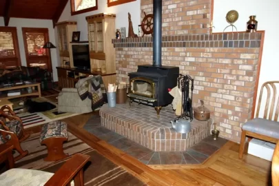

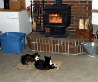

Both of mine are nothing but masonry. The brick that you see is all the brick there is. With x-ray vision, you'd see a whole bunch of concrete blocks stood on end, and lots of mortar slathered all over. They're not "solid" masonry...lots of air inside. Mine are 12" high, but if you wanted 18", you could just build up with more brick. Rick
Shop:
[Hearth.com] Tall, non-combustible, 18" tall hearth
House:
ETA: Shop hearth's on a concrete slab. House hearth's on a wood subfloor.
I like the shop cats.
