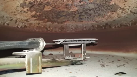

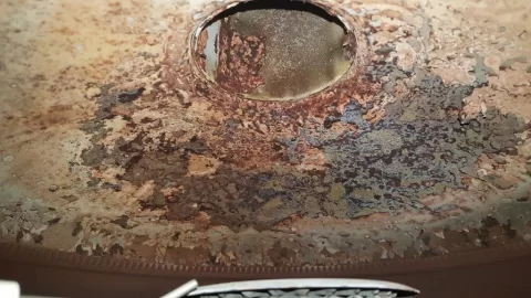

Our current water heater definitely needs to be replaced. It's so rusty that pieces of rust are falling on the burner. These pieces of rust interfere with the flame, and that causes it to shut down.

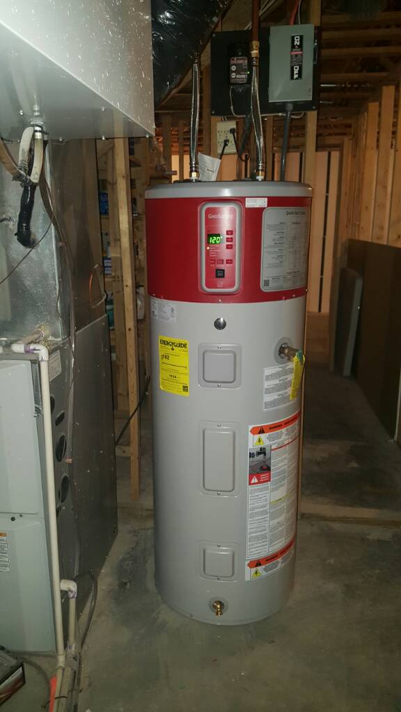

I guess we'll find out. I installed the Geospring last weekend. So far it's working great, although we haven't used the Jacuzzi yet.
