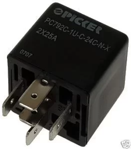

Thanks Webie. That's just what I'm trying to do. I looked at the RIBUIC relays on Ebay. They looked like they would do the trick as a SPDT relay. If you wouldn't mind a dumb question, do you screw the threaded fitting on that relay into something else like a junction box? I notice other relays have prongs on them. Do you know what the pronged fittings are supposed to connect to? Do you connect wires directly to them or do they fit into a socket with screw on connectors for the wires? If the wires connect to the prongs I dont see what would hold the whole relay in place?
Pictures below of each type. One on the left is an RIBUIC. Couldn't figure how to make both pictures the same size.
Mike

I had a lot of success with DPDT relays like this one. It can go into a socket like this one. The nice thing about the DPDT relay is that you can also put a simple indicator light on the other side of the relay. These relays are really just an on/off switch that is thrown by the charging of the coil. Here is a picture of what the terminals do.
WoodNotOil or anyone else, here's a followup dumb question. Are the sockets your link showed supposed to fit in some type of control box that would contain various switches and relays or do you just screw the individual socket to the wall or someplace else and run wires to it as needed. Pardon my ignorance, but I have to learn this somehow. Judging from my picture and yours there is not a universal configuration for the way the prongs are arranged. I'm guessing you would usually need to purchase matched sets. I've seen references to "plug and play" components like these, but have no idea what they are either. Thanks for your help.

Yes the threaded fitting fits an electrical junction box , in my case I just attached them to my taco relay .
RIB relays aren't the cheapest but they are self contained, can be hard wired any-place.

The sockets are specific to the brand and type of relay, so they are not universal. You can mount the socket anywhere you need to and just screw the wires in. For $14 for the relay and socket you can add some logic to your controls for not much money. If you are just looking to control the oil not coming on all you need to do is have an aquastat or pump trigger the coil to interupt the TT connection to the oil boiler. If you have storage, you would probably need an aquastat on that to be able to tell the relay when the tank is hot or not.
