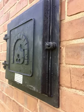

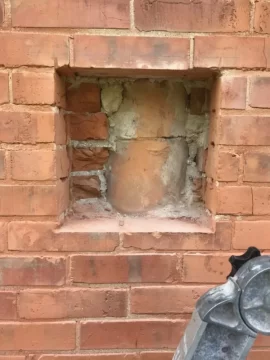

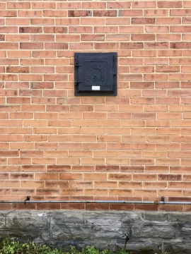

We installed a door.

Thank you! Found it on Amazon. It’s cast iron. It needs better paint (easy), and I will seal to the brick with butyl tape behind the flange as soon as I figure out where I put that.
No butyl tape anywhere in the chimney system. Make sure the bottom of the tee the cleanout any block cores etc are sealed up well with noncombustible material
Use silicone to make the gasket. Just put a bead around the door perimeter, close the door and let it set up.
The butyl tape is for the flange that overlays the brick. Door has a fiberglass seal.
You put it behind the flange and will never see it. Then seal everything up.inside with mortar
I’ll he mortaring it up in the spring. I keep a supply of era appropriate lime mortar on hand.
There is no need to use line mortar inside the chimney. And it won't last long at all if it is exposed to any creosote.
