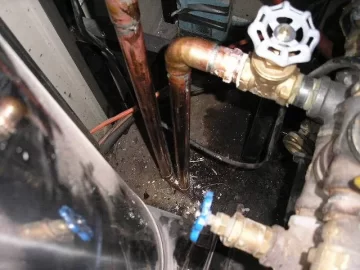

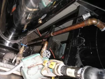

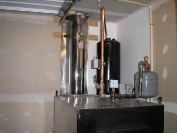

Well I finally got it done!!! and thank you all for all of the help. I decided to go with a old hot water heater tank and strip it down to the bare tank. and rased it off the ground. I have attached the Pics. Tried it last nite. Got a good size fire going and got it up to 180 deg and cut the power to the system. It climed up to about 195 and then started dropping. After letting it sit for about 5 minutes the temp was down to 150 and only about the top 12" of the watter heater tank was hot. One of the ideas we came up with while doing it was the heat trap on the cold return which I think made a huge differece. It does not allow the heat to flow to the bottom of the tank. All in all I think the valve was $165 and about 50 bucks in copper. I got the water heater for free. Can sleep a little easier now!
