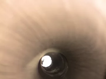

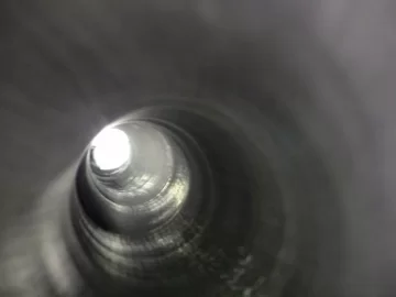

So I should be worried about what looks to be change in shape. I will try to get pic.
This is a couple of picture's of the liner. May have to much zoom in them.

Liner looks great. Don't add wood on a hot fire. It's asking for the stove to take off like you have been seeing. Let the fire burn down before reloading.
