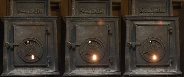

Here's a composite photo I took last year of my old stove during a starting burn using three progressively smaller intakes air openings, each one 1/2 of the one before. No flue pipe temperature data because I din't use a flue thermo back then, but all I can say is that the stove was warm to the touch when I began and the flue pipe was scathingly hot before I started to reduce the air. Each time I halved the air, you could hear the stove accelerate and see the temperature inside the burn zone increase by the change in color. At 1/8 air, the coals inside were yellow-white... well over 2000ºF. Unfortunately, the fire was so bright that I had to make adjustments in the exposure to prevent it from blowing out the photo, so you really can't see what it looked like in person.
If I were to use stove top temps at the time I took the photos (taken about five minutes apart) at that particular time to monitor the burn, I would have predicted it would have been making massive amounts of creosote, but that was how I ran that stove with thin splits and dry wood, and there was never a trace of creosote in the flue anywhere near the stove. I'll guess that stove top temps eventually rose to about 700-800ºF within about 1/2 an hour from then.
This is the first time I've posted a photo on this site, so I hope it shows up. And don't beat me up about the condition of my poor little Jotul clone. It was a great little heater that cost me nothing but some stove cement, a couple of feet of gasket rope and a few hours work on a buddy's guitar. It saved me about $50,000 in electric heat over 18 years of 24/7 burning from Nov-Apr each season, and ate about 80-90 full cords of wood without complaing too much until the very end. And while it looks like it is leaking air badly around the joints, it was still quite air-tight, and shutting the air down completely in that stove would snuff the fire right out.
