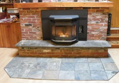

Ok, I have a pic of the new stove in place and running. We still have to clean up the ledge underneath it, and grout the hearth and trim it.
  • [Hearth.com] Thank YOU and a question II..

Thanks for the video, jafo....the stove looks great! I did notice how quiet is is.....NICE!

Jafo,
Very nice looking install.
Using the pellet stove and NOT having to worry about having it start another house fire should give you priceless peace of mind and enjoyment.
Good choices and well done!!
Ranger
