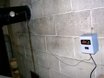

I have a Fisher Grandma Bear also. 500* is nothing to get exited about, I don't start worrying until it's get over 800*- 850*.
Here is a story:this was before I installed the baffle and sec air tubes. I have the temp monitor/alarm set to 800*. I loaded up the stove ( must have been some very dry wood) and went up stairs ( stove is in the basement), I heard the alarm go off, in the minute or two two it took me to go down stairs the temp increased to 1100* :ahhh: , I quickly closed the air which brought the temp back down.
This is why I am a firm believer in knowing what temps the flue and stove top are running at.
I have a monitor/alarms for both flue and stove top on each of my stoves.
Now with the baffle and sec air the stove is much more controllable.

800-850 on a probe thermometer right? Or on a magnetic type? 500 on a magnetic type is a lot different than 500 on a probe type thermometer.
