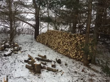

Mostly oak with some black locust and hickory mixed in stacked in the spot that gets the most sun during the day.

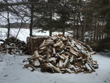

Next years 16/17 wood stacked in the background on the edge of a pine tree hedgerow. 17/18 wood piled up waiting pallets. All down the hill in the backyard.

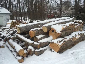

Poplar hopefully drying out for next
