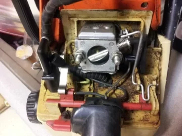

Looking at your pics up at the top... aside from the missing air filter, the fuel line is disconnected from the carb, and the plug wire is wrapped in electrical tape. It obviously won't run if gas can't get to the carb, and electrical tape is no substitute for intact plug wire insulation so the ignition might be shorting out. Since it wasn't running when you got it, and was disassembled to a degree you haven't described, there could be all sorts of things going on that we don't know about.
I agree with Jon there could be lots of stuff that you have not uncovered yet.
