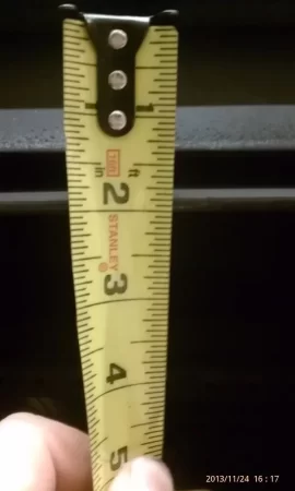

Sorry BB, I measure 3/16" top and 1/8" body on the 30. Either your measuring stick is broke or they thinned out the 30. I even took pics.
First of the top and then of the thin airwash deflector.

I don't know what to tell you. My tape isn't lying. Clearly not 1/4" so either your calipers are junk or your stove top is thicker. If somebody sold me that as 1/4" I would accuse them of ripping me off.

Yeah. The calipers must be junk when they show something that is supposed to be a quarter inch thick to be .256" and something that is supposed to be 3/16" to be .1875. On one made in 2005 and one made in 2011. ;lol
Your tape lies. That is why machinists don't use tape measures.

Don't know if the king is different than princess but my top is a 1/4 inch with a tape or a caliper. The only body plate I can measure while hot is 1/8 inch.

The difference between 3/16" plate and 1/4" plate is something even a lousy engineer can spot with a tape measure. Even at just 3/16", I'm not worried about the top melting. That step bend seems to add quite a bit of rigidity.
