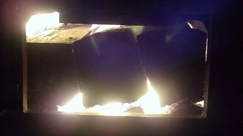

I'd only burn monster splits if I could. Unfortunately, you make a whole lot of regular splits building up a stash of monster splits. I'd like to try 2 big cat stoves side by side so that one could always be on the way up while the other was on its way down and between the two you could always put out exactly as much heat as you wanted.
