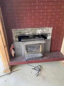

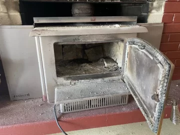

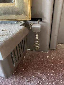

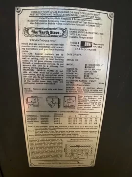

Hello, I am looking for information on The Earth Stove Model 2500HT EPA Certified Wood Stove Insert. I can't seem to find any information on it anywhere. I am about to purchase one for $150 and included 15' of stove pipe. It seems like a steal of a deal to me! I am assuming the 2500 in the model number means that it can heat up to 2500 square feet. Please see the attached pictures. Any information would be much appreciated. Thanks!

The model number has nothing to do with the area it can heat. It's just a model number. The firebox size is about 1.7 cu ft. It's a very early EPA stove. Lennox bought the line.
The stove looks in rough shape, but with some cleanup, including the blower and new firebrick it may work out ok. $150 is a cheap deal, so spending a bit on it is not going to hurt.

Yes, I do plan on cleaning it up. I do have plenty of firebrick to replace the old ones and I assume I will need to replace gasket. Thanks for the reply!
With some love, new bricks, paint and oiling the stove should work out. Check to see if the bricks are standard firebrick or pumice brick. The latter will be notably lighter than the standard firebrick.
