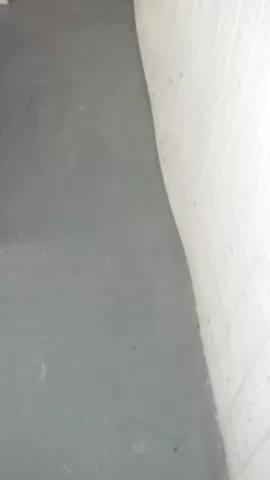

Is this a T1-11 type paneling? If so, it will likely warp. My wall is just over 36" from my 30-NC and after 2 seasons has really done a number on it.
The ceiling is much higher, so if its a thicker stronger material? Than there should be no problems.
Here is a pic of wall. We will be tearing it out this Summer and opening up the basement and finishing most of it...
