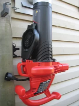

I have an OAK so I also plug up the air vent outside to keep moisture out during summer, then top off with damp rid......btw: check out my kewl tool I learned about here to clean exhaust pipe.
