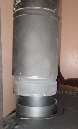

I have one more question, please and thank you. What do I need to do here? The new stove is just a bit shorter than the other.
  • [Hearth.com] The firebrick puzzle
Need a longer length of pipe.
Looks like the pic is a piece of telescoping double wall, it isn't just stuck?can't be extended?
If not try to ID the pipe and get a telescoping section that'll fit. The fit is specific to the manufacturer.
