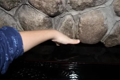

Here's a question I have not asked......should I have a good deal of heat from the stove when it is an hour into a full load WITHOUT the fan on? I don't. I feel almost no warmth without the fan on.
Another question, if we put in a block plate will that help the overdraft problem or do I need a flue damper? I attached (hopefully) pictures that show the huge gap between teh stove and the opening of the fireplace. Installer cemented the top of the chimney, we do not feel a draft her. Might this be a good place for a flue damper adjustment to com in? Am I thinking correctly?
If I load up and start shutting down, within 15 to 30 minutes, depending on how many coals before reload, I can't stand next to stove because it's thowing too much heat. Once you get to 350/400 degrees the glass is so hot you can't stand too close. You'll know what I am talking about once you get to these readings.
A block off plate will not control your draft, it keeps heat in your firebox as opposed to running up your chimney. It also keeps the surrounding external areas of the stove hot so it doesn't cool the stove down.

The wood is oak. The man who sold it to me burns it in an insert in his own home, he came inside, looked at my burning, and thought something was up since it wasn't that warm in my house and that when I shut it down all the way there was still a good deal of draft. He said his give much more heat.
#4 is again the one that seems like the problem. We are still seeing active flames rising when fully closed down.
#5 the stones are WARM, not hot. When we have the blower off, again, there is barely no heat. We imagined that the rocks would be hot and they are not. We have no radiant heat effect.
Our house was built in 1987. We have very large windows, but they are double paned anderson windows. There seems to be insulation in all walls.
You are seeing me through to the end with this, I really appreciate it. My installer doesn't burn wood, so the more information I can supply him with, the better.

If any setting open on the primary makes raging flames (but no heat felt) and closing it full makes those flames drop to zilch (and still no heat felt) it all points to over-draft.
Sherry Ann - here's something to try. When you get to "little blue flame with primary closed" stage - what happens if you crack open the front door? Do you get a lot of suction against it? Feel/hear air rushing into the fire? Flames rage up?
If you answer YES to those questions, you just might have an overdrafting stove.
You are running 30 feet of un-insulated 6" SS liner in an un-blocked-off, exterior chimney. Your installer has done everything possible to make that sucker a draft-producing machine.
Add a blockoff plate. Insulate the liner. Find some way to add a flue damper.... ALL of those things are ways to REDUCE your draft, KEEP the heat inside the stove longer, and thereby INCREASE the heat you feel.

I did open the door, it does create a RAGING fire when I do that .
The picture is small on post #53? There are two pictures of just the top of the stove and my son's hand sticking in the hole. On my computer they are at least 3 x 3, I didn't mean the tiny one on the left of my posts.
I live in West Kingston. I can get to 95 very quickly but that takes you to SE CT. I think I should let him try to fix what he can, block plate and insulation, especially since I clearly paid through the nose. However, if I want to put in a flue damper, I might consider your installer for that. I don't want to break ties yet because I paid so much! I am considering contacting the reginal rep from Hampton, he lives fairly close. He should know what is going on........
If I crack the door, the fire does rage up tremendously. Now we are getting somewhere.
Bingo - you're overdrafting. The good news is this confirms you have tight door seals, and a very good functioning primary control.
I really hope the plate and insulation help - but it really wouldn't hurt to presume they won't, and start getting the wheels in motion NOW to add a flue damper. Talk to chimney sweeps in the phone book, if you're at ground-zero w/ your installer - I assume he doesn't know anything about sweeping if he doesn't burn himself. I doubt the Hampton rep is going to have much to say, either.
I will add this: if it was NOT recommended or allowed, they'd say so in the manual. The fact that it's an insert makes it generally impossible to easily add one, so I'm not surprised they avoid the topic altogether. But you have unique circumstances here w/ good access and an exceptionally tall chimney, it sounds... Worst case is you install it and running with it full open is like it's not there.
And finally, back to your air control - you have essentially an ON/OFF lever now, right? I had the same thing w/ my 30+ ft liner on my Heritage. Until I added the damper. Now I have actual adjustment sensitivity from the primary - it's a beautiful thing.
