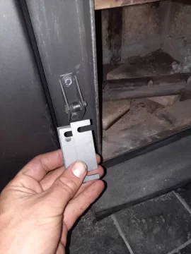

Door doesn't seal the best on the latch side. Dollar slides faily easily out. Reached out to P.E. but nothing back so far. I can always make something so it latches tighter but shouldn't have to.
