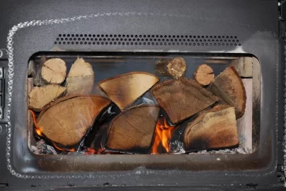

OK, for those HI300 owners having problems getting their stove to 300+, here's a sure way to get to 400/500. It works every time for me so I hope you can get there.
Stuff the stove like the second picture. Let burn like the first pic. Start knocking down slowly to 3/4 closed. Take your time getting there. Started at 300 degrees and 1 hour later, close to 500.
Try this and post your readings. Good luck!

At what point do you put the fan on? We're just loading it up now for bedtime. It seems like the fan should go on a few minutes after closing it down most of the way. That seems to keep it the hottest am I right? Those kinds of pictures are exactly what I need. This is wood burning 101 at its best!
By the way.....you know that smell you get when the paint is curing? I'm getting it now, six weeks later. That's how NOT HOT my stove was......
Thats what I call stuffing the stove. Got to 400 this morning. Great pics. Sherry Ann- I am happy you got this thing working.
Glad to see you got to 400 degrees and smell paint. That means you've heated the stove to a point it hasn't seen before. I bet you can feel the heat now!
I do not run the blower when trying to raise the stove temp. Once I get the stove to the right temp (400/500), I run it a while until I totally shut down.
Remember, fan should only be used at full to half way closed. No blower beyond the half way point.
