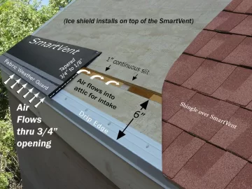

The eaves would need vented, but you MUST have a ridge vent ALSO. You must have both.
Air moves across the ridge and draws from the eave vent.
We installed new shingles last year and took advantage to add both ridge vent AND eaves vents. We have a cape cod so we had to use a special eaves vent. (since there is no room for a conventional fascia vent there.)
I will try to find the info.
Here it is....
(broken link removed to http://www.dciproducts.com/html/smartvent.htm)

There are soffit vents and ridge vents as well as vents on either end of the the house in the attic.... My question is this... The soffit vents need to be able to flow air up to the attic, i get that... but does the actual roof "plywood" need vented as well.... because I could run some pipe down the eaves to vent but since the house is finished and sheetrocked I cannot install the styrofoam vents that you staple to the underside of the plywood. I'm not sure if that makes much sense but I tried...lol
Yes, the actually roof deck needs to be vented, it prevents moisture from building up on the underside of the roof deck, causing the plywood to go bad. It also prevents the shingles from getting too hot and curling. Also you don't want gable vents and ridge vents. It short circuits the venting system.
