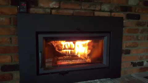

After reading through all the blogs I decide to buy the CI2600 in October. Since then I have had several fires and am pretty happy with the burn time and heat output. I am wondering about the effectiveness of the air wash as my glass gets regularly quickly dirty with buildup once I close the damper. Even if I leave the air intake at full open. Does anyone have a similar problem or a suggestion?

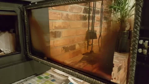

The last days I did continuous burns resulting with the same effect. The following is after last nights burn where I had the air 1/4 closed. The left corner is worse the right (viewing from the below side). I need to scrape the buildup off as you can see.

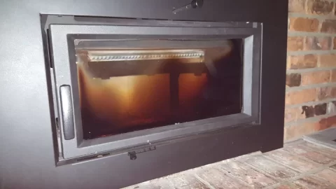

This morning I build a new fire after completely cleaning the glass (which I now am pretty good at :) ).
After 2 hrs I am getting this again, starting in the same corner and also building up on the other side. The catalyst is engaged and I have 950F.
I really have some concerns about the air-wash as this should prevent this, or not?
Anyone else experiencing this with the CI2600?

This stove is like a Ferrari it doesn't like to run slow not that I own one just rented one for a day. Once you start filling the stove with wood any where from 7 to 9 pieces and the air 1/2 to 3/4 closed that glass will clean up.
