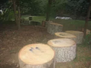

I wouldn't get it. Looks like it doesn't convert to vertical. Which means a person would have to lift a heavy size round on to that thing to split it. Notice only small rounds where used in the video.
Trying splitting these with that piece of junk...
