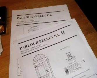

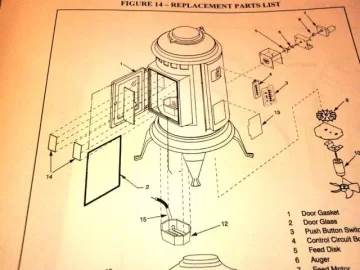

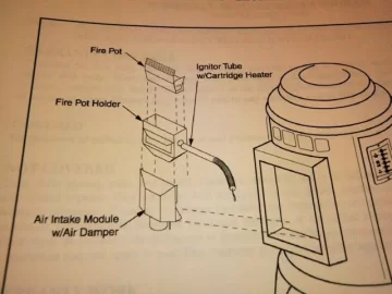

I was emailing a fellow Thelin owner and was writing about cleaning my Thelin Parlour for the first time...anyways he mention what I had to do the clean the firepot...after a couple of emails and photos we discovered that my firepot was completely different then his....well I just called the company and I guess Thelin did change the firepot design...What puzzled me is that I had the older manual wih the newer stove and things did not match up..so the next thing I did I downloaded the manual off the Thelin website...as you can see the manual is titled different along with the firepot assembly drawings...It's funny I researched this stove and never came across that Thelin changed the firepot design...the one in my stove only has the cast iron firepot....and the ignitor is located on the left side of the pot..see pics below..the newer model is the last pic with the cast iron firepot..the older one has 3 parts to the firebox area...and the ignitor is located on the right side..

Cast iron should hold up better. The stainless pot in the parlour I had developed a bunch of cracks after just a couple years. The ignitor was centered in the bottom of the pot. The pot kinda rested on the ignitor so the pellets would have direct contact with it.
Yes I think this is a better design...so far it has been running great..very easy to clean the pot/stove firebox area..

With that said, my main reason for adding to this thread is to note that there is another Burner Pot / Igniter design which is the one I am using. The Burner Pot shape appears to be similar to what your drawing shows, however, the igniter is shorter than the original and comes into the pot from the right hand side when facing the stove.
I would be curious to know if and how much better the stove works with the latest Burner assembly and the logic behind the evolution from what I have to the latest design?
