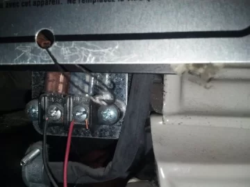

Where do the wires attach to the stove? Are they attached to the
TH & TH-TP locations on the valve terminal block?

I just looked at where they are connected. I don't see any markings, but there is only one place to hook them to. Red and Black wire. One hooked to each.
Can you take a pic & post it here?
here's the connection.
