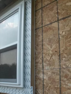

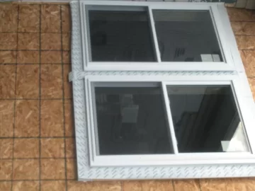

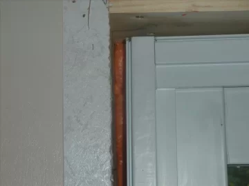

By sealing... All windows have been sealed as well as possible (caulk and Lots of it). I still use plastic sealing kits, all.door seals were replaced, all Outlets and Switches have been sealed and insulated. Basement Sill has been sealed (did that one last year because of Basement stove addition) I should have been more clear. :(
Yes. 1/2 drywall may not be much (X2 layers) . But when compared to the 3/8" garbage a lot of builders use now, along with 2x4 construction, it is still a lot better than most. It may not seem like much. But I must tell you, it Did Help. Every bit helps. In my opinion.
My house is no Mansion. But when I compare my usage and heat needed compared to others (be it friends and family or those here)
I understand what you say about my 17 yr old house. But over the last 4-5 yrs (Majority done within this time period) I have Peeled and Sealed this entire joint. Many times over :) It may not be the newest or tightest around. But I am much happier (and Much Warmer) today, than I was years ago.

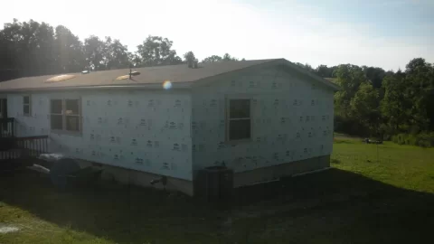

Last year we were gonna reside the house (hard board insulation (R5) w/ insulated Siding (R4.7 IIRC?))and redo all trim, gutters, soffit, etc.. Probably gonna happen this year. With a Quote of about $20K to do house and garage (this means all new doors for house and garage also/because Mama wants to change the colors entirely :() it was put on back burner.
Most of basement is finished (or walled off /insulated) except the laundry/wood stove/furnace area/both furnaces) Yes, its a heat sink. But the wood burner gets it to 80°-90° with ease and keeps it there. The Fahrenheit then idles most of the day (when used).

Oh i did the same thing. I understand, being an Architect, the correct way something should be done to a house, but then you factor money in and that sometimes goes out the window....but i added a pellet furnace 3 years ago, and last year i had 2" of polyiso rigid insulation to the exterior along with new siding, windows, doors, etc and my fuel consumption went from 7 tons the first year to 3 tons last year....not sure exactly how long it will take me to pay off the 28k investment into the exterior at 800 bucks a year (average cost of 4 tons of pellets) but at the same time i can sit in my living room in a t-shirt and not feel cold cause of the drafts through the windows. Yes an Architect lives in a single story ranch...we dont make as much as people think...
