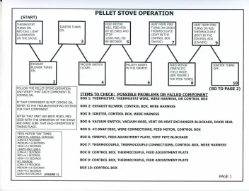

Here is a sheet with your auger feed times.
Make sure that it is spinning at these times for the selected firing rate.
