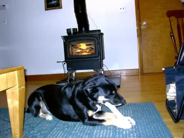

I picked up this nice Regency for only $250 on CL several years ago, and am very happy with it. :-)
