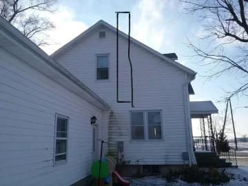

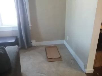

I have one place in the entire house where I think I can make a stove work. I'd like to know what you guys think. I'm open to suggestions. The wall on the right is 54" long and it's 37" to the baseboard. The right wall will be turned in to a half wall and both will need to be protected. The cardboard pieces on the floor are the dimensions for a jotul f118 and f602. I'm also considering a morso 2b. I plan on building a brick hearth that goes from the baseboard to the end of the 54" wall. The stove pipe will exit out the top then out the wall. From then on class a to the roof.
So what do you guys think? Am I missing anything? Will the chimney above the meter be a problem?

You may want to contact your electric utility co and make sure they don't have an objections to the chimney t being near the meter pan, I believe most utility co want 1ft on either side of the meter and 3 ft in front, the chimney T will be a little lower that your drawing for better access and cleaning.

I think u will find the the 118 firebox size 50% larger than the other 2.
This will effect your output and burn time.
The sidewall setbacks might throw your plans off a bit. Take a look at those specs.
Additionally you will find convective type stoves will have less setbacks than the radiants.
Joyful has a upright convective stove and morso a few as well that might fit in the setback space.

Move the stove to where you can go straight up through the house, in the corner or closet of an upstairs room with a chase. Outside, the chimney gets cool and doesn't power the stove as well.

After reviewing the photos again, I would try and find another location for a wood stove.
Well we had a slight change of plans since this post. I found a nice used jotul f400 castine that i couldn't turn down. Also found a new place for it. Going to have to knock out a built in cabinet but thats no big deal. This will allow me to go straight up through a second story closet. Planning to install next summer/fall. Working on my wood stash now.
