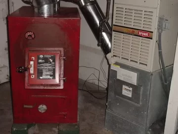

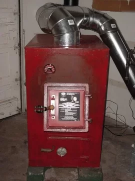

My house is a cape cod design, story and a half. A lot of small rooms down stairs and two bedrooms upstairs. The house is 11 years old , with 2 x 6 exterior walls. So there is extra insulation in the exterior walls. I did find an installation on the web where someone hooked up a hotblast 1500 furnace to there existing down draft furnace. I would have to run my heat pipe somewhat the same way to get it to my crawl space. I have added a some pics of this, tell me what you think. Looks like he ran both 8" heat pipes in to one 8" then to furnace

cant really tell from that pic. but I would run both 8's to the furance
2 8" ducts reduced into 1 8" duct= 1 8" duct of heat. A 8" ducts carries 200cfms of air. The larger unit already has a larger blower. Also has a large opening on the top for a plenum. You can run an 8x18, or 8x20 and get your heat into the home. With 2 8" lines, and 2 90's in each you will cut your flow in half. By the time you make it to the plenum, you have not enough flow for the system, no pressure to get the heat into the plenum of the furnace. You will need a backdraft damper in the main furnaces plenum, which will stop backflow. Your best bet would be get a 1600 and go from there. Also when a line in ran into the home, insulate that line. One other thing is in order to get the system to work properly, you will need to get a cold air return into the house from the furnace. And last, with the furnace being in the garage, the 1600 is insulated, so you won't lose alot of heat due to an unheated space.
