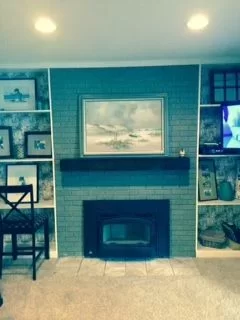

Alright, it's go-time. The installers were out on Wednesday - they cut and laid the tile and rerouted some electrical up from the basement (for the blower). They also removed the old glass door and fire grate, and cleaned the interior of the old firebox.
[Hearth.com] This forum is cool...
They came out today to finish the job. Ran the liner kit down the chimney, flashing and cap, installed the insert, grout on the tiles, and hung the mantle (I built that mantle and saved a ton).
Naturally, that painting is just keeping that spot warm for the TV...that'll be my next project. Hopefully I don't electrocute myself. I also want to order a cord of wood (at minimum) to add to the one I've already got.
90 degrees this weekend in Michigan. Not too hot for a couple break-in fires is it? Speaking of which...any advice on that from you pros? To be honest, the instructions for first fires in the manual were pretty crappy...

Nice, man! Details? This stuff gets me jacked...nice talking to people on hearth.com about it because nobody in real life will listen. I can see my wife's eyes glaze over, and hear the gears whirring in her brain ("hmmm, should I make chicken or hamburgers for dinner tonight?") when I start babbling on about fire, and wood stoves, and heat, and so on...
Congratulations. It fits right in there. Draft may be weaker due to the warm temps. No real need to do a breakin fire other than baking the paint and maybe drying out residual moisture in the bricks. The paint won't get baked in until the stove body gets over 450-500F. I'd wait until September, but If you must burn, wait until a cool night in the 50s or 60s, open up all windows, put a fan blowing out of the closest one, and burn away.

Nice looking install. You've made a lot more progress than I have. I bought my insert back in January, still sitting next to the fireplace on the pallet with the liner in the box in the garage. Some day when it's not so hot and other things aren't taking priority (and I can get a helping hand on the roof).
As for the break in fire, I'd wait until Sep or so once it gets cooler at night. Just warn the wife, it'll smell.
As for the cord, see if you can find someone that's selling that will let you test it. If it's not fully seasoned yet, should be getting close and you can let it continue. Don't get caught buying wood that was just cut down, it just won't be ready for this year.

Your Nap insert looks awesome - nice work! Have you fired it up yet?
Thanks! I really love the style of the Napoleon EPI3T, I just hope the quality is up to par. I will definitely provide regular reviews on this bad boy as time goes on...
Funny you should say that - I was HIGHLY considering lighting up the initial break-in fire last night. It was about 50 degrees when the sun went down. However, my wife is over 8 months pregnant and she was a little concerned about the potential effect of breathing paint fumes, so...check mate, I guess. Instead, I spent the evening building a crappy log rack out of 2x4s that were laying around in my garage, haha. Looks like Picasso built it, but it'll play.
