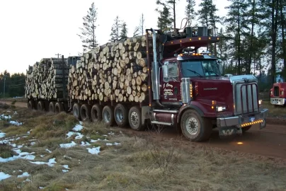

This is what a 20 cord load looks like in Michigan. With this axle configuration, the truck can legally gross 164k. If this load was dense hardwood, I'm sure it would be 200k+. That's lbs, not kg.
I'd like to see my neighbors faces if a truck like that started unloading in my yard. The pile might fully cover my front yard! I don't even want to know what my wife would do, ha!
Day-yum Jeff, my back went out just looking at that picture.:rolleyes:
