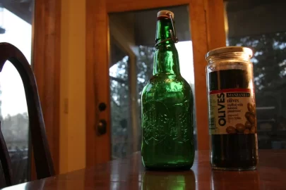

This is how much creosote i harvested today.

It was so warm out, i thought i could clean my chimney for the first time this burn season. I was pleasntly suprised at how little creosote i got. I have burned three cords of mixed pine this season.

Dude, throw those olives away! They look nasty!
On the plus side, the fact that you don't even have a bit of creosote in the Grolsch bottle is amazing!
Congrats!
<grin>
Good job, burned some good wood, huh?
Joshua
I dont know if its the wood quality, or a complete comustion quality of the stove/chimney combination. Im happy, i sleep better at night when i get those results. And for the record, i never turn my stove down. When its running, its full blast. I let it cool down, the relight for the second fire of the day. This method alows me to only burn two fireboxes of wood a day, 6-8 splits. I keep my consumption down and my cresote down. One of the benifits of soapstone IMO.
Maybe if i mix a few of those olives in my vodka....
