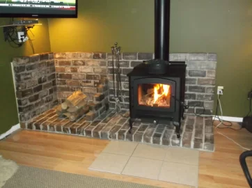

the far side of the step wall divider I built into my heart is exactly 27" from the 30 and I often have splits piled in there to the top of the final step and beyond. Look at your owners manual for required distance from combustibles and add a little for safety and uneven stacking and you should be fine. [Hearth.com] This is probably dumb, but I gotta ask

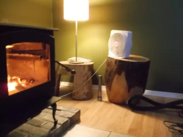

120 is not going to get it done. Look at that split in the corner of the stove still smoldering in the lower corner after a reload while the center of the stove is already blazing - it is kinda hot in there!! I know the situation is a little different but my point is - 120 is no hot enough and I am very risk averse. The stump tables I built are 33" from the stove and I feel them sometimes out of curiosity. They are warm but no worries. No where near as warm as the dry wall behind my DBL wall pipe.
