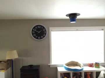

Here's some pictures to help. My current set up is obviously in the ceiling. Right now there's an angry birds bucket taped to the ceiling so that the creosote doesn't fall into the house (I need to buy a brush to clean that out). My stove is ideally where we would like it. It's in between the window and our cabinets that holds our TV. Now if you look very carefully you can see a screw sticking out of the ceiling right above the clock. That is roughly where the chimney will come through if I put the two 30 degree elbows in.
I would like to have it come over maybe another foot. What can I do? I already purchased a telescoping double walled pipe to go up directly into the ceiling but I don't think I'll be able to use it if I don't get it moved over.

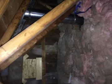

Picture of the attic if it helps

It might be helpful to give the stove model and what the manual says are the required clearances to combustibles. Have you made sure all clearances will be met with the final stove positioning?

You should download the instructions for the Selkirk product you are using to see what they permit. I believe you are missing an insulation shield in your attic to keep the fibreglass away from the flue. I believe it requires 2" air gap from all materials. You may be able to use quality connector pipe elbows to connect the stove and flue- it's hard to say without measurements. You will need to look at the Selkirk manual and the stove manual to make sure you meet the requirements of both.

Yea, i'm sure selkrik has their own offset chart, but I expect theirs is similar to what I posted above. I think using two 45s to connect to the existing ceiling support box would look pretty goofy. Moving the chimney is an option, but you should find out if using 30 degree offset elbows would work.
My original plan was to use the stove where we have it now and use some of the single wall pipes which are left over from the previous owner and connect to the current chimney set up. It would look hideous but it would only be temporary. In the off season I was going to look into moving the chimney to where we want it.
