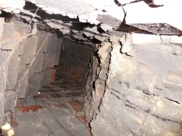

Here is the 45* run above the smoke shelf. At the end of this, which we can't quite see, there is the straight run of 8in terracotta. Just so many bricks to get snagged on it makes me nervous.

Are you sure it is 8x8 liner on the fireplace side? I can see that for a furnace in the a basement but it's a bit small for an open fireplace. With two people I think you'll be able to work a 5.5" insulated liner past the corbelled brick.
th opening there is much bigger than 8" that doesn't look bad at all to get through lots of room Personally id pull it from the bottom with a piece of sheet metal between the liner and that brick.
If I had to guess the 45* would be 10-12in wide.
I would not give it a second though personally but I have done hundreds of these and yours doesnt look to bad. but if i was doing it and it is infact 8x8 i would break out those old liners so it could be insulated
I really dont see that it will be that much trouble
A pulling cone will help keep from getting snapped on the bricks.

Id still use sheet metal especially if it is light wall i have seen them get torn on rough edges like that. But yeah definitely a pulling cone to
Yeah, but unless you line the whole stack with sheet metal, there is still the entire run of jagged bricks to snag and possibly tear on. Especially if he is going to insulate. Might be better off using flex at the bottom and rigid double wall from the 45 to the top.
Not from what i can see to me it just looks like a rough smoke chamber
