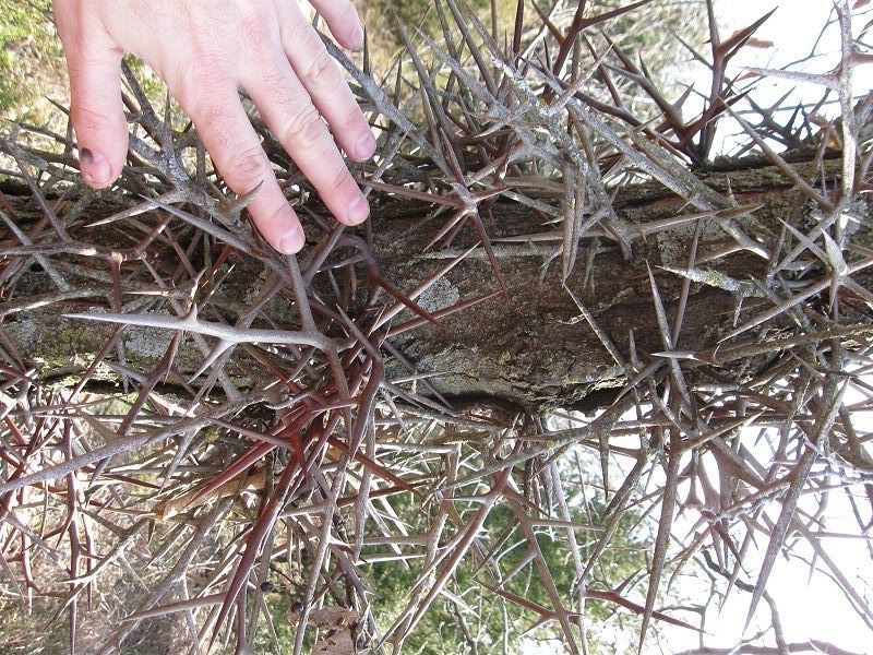

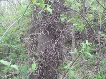

[Hearth.com] Thorny Locust vs. Ash
Ok.. So my locust doesn't look like that at all. The thorns are on the branches only.
Wow I've never seen that kind of locust. Not around here. Black and honey locust here. I use a carbide chain for mulberry, locust and Osage. It gives you much better cutting power. I don't sharpen them myself though. Last three times as long and is more forgiving if you nip the ground.
That is honey lockust.
