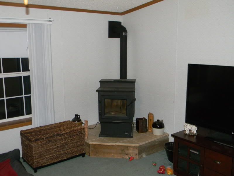

    Stove is on an out side wall. Pics can describe it better than words. The pipe goes through the wall and has a stainless adjustable termination cap on the end. Critter guard is currently removed as of a couple of days ago. Glass does need to be cleaned.

    This is the second winter with the stove. It had some other issues last year that were caused by the critter guard having lots of ash stuck to it an caused a similar issue but it wouldn't run correctly on any setting. High worked fine for the first bit of this heating season and now it doesn't.
